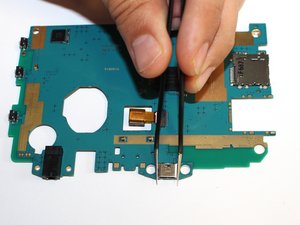

+[* red] Use a soldering iron to heat the old solder until it melts.
+[* black] Remove the melted solder.
+[* black] Use precision tweezers to remove the charging port.
