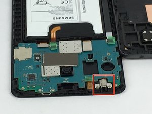

+[* red] The headphone jack, shown in the red box, is held down by a metal jacket.

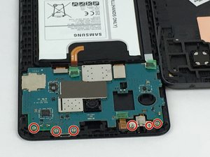

+[* red] To undo the metal jacket, the mother board needs to be unscrewed to be able to get under the jacket. The screws are shown in red circles.
