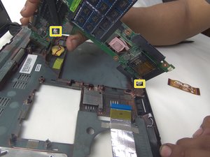

+[* yellow] Slightly pick up on motherboard and remove the two connectors.

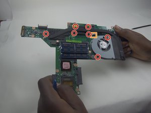

+[* orange] Disconnect the cooling fan connector.

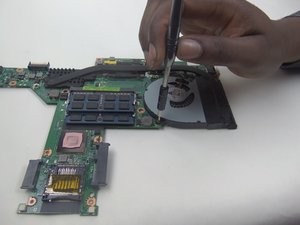

+[* red] Unscrew the 7 screws holding in the cooling fan using a Phillips #00 screwdriver.
