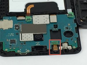

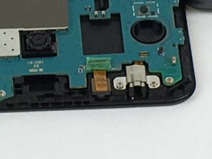

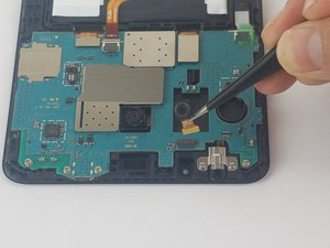

+[* red] Using tweezers, at the end of the gold wire, gently lift the black tab locking the wire connecting the camera to the motherboard.
+[* black] Pull the wire from the connector.
+[* black] This is the only connection for the camera to the motherboard.
