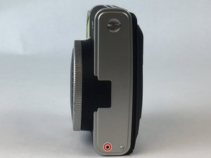

+[* black] Looking at the top of the camera, flip the camera 180 degrees to locate the bottom side of the camera.
+[* red] Take out the 1 screw, sized 3.75 mm, located at the bottom of the bottom side, this time with a Phillips #00 screwdriver.
