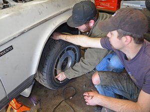

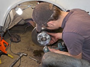

+[* black] Place the wheel adapter over the existing wheel lugs and install and hand-tighten the lug nuts.
+[* black] Tighten the lug nuts to 85 ft-lbs with a torque wrench or impact gun.
+[* icon_note] You may use whatever size adapters are available to you. We chose 5x120.65 adapters so that we could equip our Volvo 240 with Corvette wheels!
