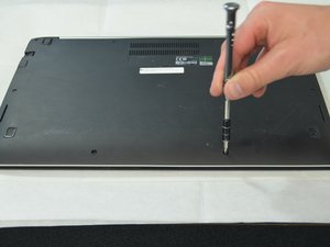

+[* black] Use a PH1 phillips head screwdriver to remove 10 screws around the perimeter of the back plate.
+[* icon_note] Place screws where they cannot be lost as they will be used to put the back plate back.
