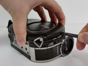

+[* black] Close the LCD screen and turn the device over.
+[* black] Insert your spudger or other plastic pry tool into the small gap between the device housing and the door.
+ [* black] ''It's best to do it just above where the word 'close' is printed as that is where the locking mechanism is located within.''

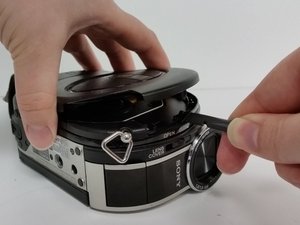

+[* black] Pry open the door with the spudger, using your other hand to tug the door as you work it open.
+ [* black] ''Caution: this has the potential to damage the plastic piece that locks the door into place.''
