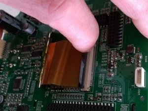

+[title] Disconnect LCD Cable
+[* black] Carefully lift the black tab on the LCD Connector to release the LCD Cable.
+[* black] There are 4 black clips holding the LCD Display to the other side of the mother board. Gently release the clips by pressing down on each one, so they pop through the other side.
+[* black] Thread the LCD Cable outward, through the slot on the motherboard.
