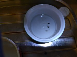

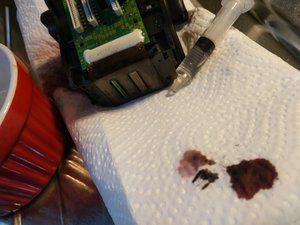

+[* black] when cleaning : do not spill distilled or orher water on the PCB, clean arround with cotton swabs. use the syringe with distilled water , spill it over the print head and clean with the swabs.
+[* icon_note] i mentioned 2 bowls : one with normal water and one with distilled. The bowl with normal water is to clean your syringe...
+[* black] after cleaning : let it dry for a couple of hours.
+[* black] if you spilled some water to the PCB : instantly clean the PCB with isopropyl alcohol.
+[* black] in the last picture you see 3 or 4 black spots in the water. that where little grains of hard dry ink.. and causing my printing problem...
