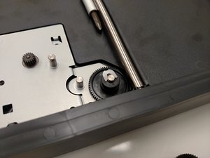

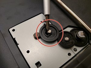

+[* black] Remove the 3 highlighted screws. For the gear driven by the motor, press the tab in highlighted gear to remove set gear. For the gear that was attached to belt, remove C-clip to remove gear then pull the last gear off.
