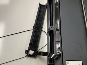

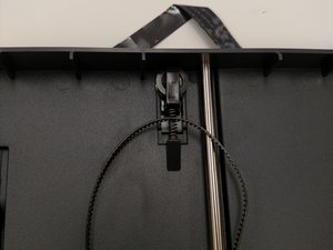

+[* black] To remove the belt, first place the image sensor to the side then press down on the gear base to loosen belt and remove from the gear.
