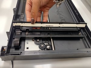

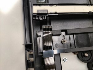

+[* black] To remove image sensor, detach the wire strip and pull it out. Remove the two springs that are under the image sensor after its removal.
