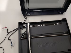

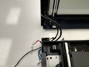

+[* black] Place on opposite face, and gently pry upper and lower scanner portions apart. Remove the 4 plugs from the lower scanner portion.
