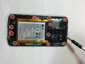

+[* black] After removing the outer phone case, you will need two Phillips head bits. One J0 and one J000 size.
+[* red] There are 11 silver screws for which you have to use J0 head bits, and 1 small black screw for which you have to use a J000 head bit. Make sure to keep them in a safe place, they are small and easy to lose.
