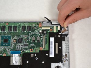

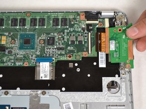

+[* red] Use the spudger to flip up the plastic clamps holding down the ribbon cables.
+[* red] Gently pull ribbon cables out of the clamps.
+[* orange] Gently pull the black cable out of the white socket
