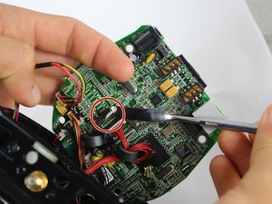

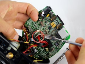

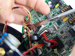

+[* black] Separate the three indicated outputs from the motherboard with metal spudger.
+ [* icon_note] There is electrical adhesive on the output. This can be easily separated with the metal spudger.
