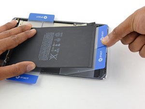

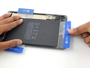

+[* black] Slide the two cards at the lower edge of the iPad left, directly under the battery.
+[* black] Lift up on the cards to break up the last of the adhesive holding the battery to the rear case.
