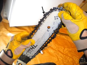

+[* icon_reminder] Make sure the chain is positioned correctly. The chain on a chainsaw rotates away from the operator if you are looking at the top of the saw.
+[* black] Position the chain so the teeth face away on the top of the saw.
