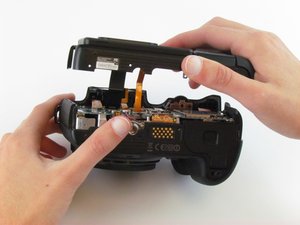

+[* black] Use your fingers to pull the back cover away from the front cover.
+[* icon_note] Do not completely separate the back cover from the front cover as two cables hold these components together.
