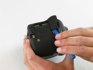

+[* black] Use a small plastic spudger to separate the back cover from the front cover.
+[* icon_note] Pry the back cover in this order: bottom, right side, left side.
