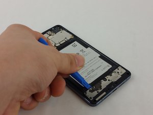

+[* black] Using a PH000 screwdriver, remove the 8 screws from the logic board, circled in the diagram.
+[* icon_note] We removed the screws when we removed the screws for the top metal cover. As long as the screws have been removed prior to removing any cables or wires, the order in which you remove the screws does not matter.
+[* black] Once all the screws have been removed, use the plastic spudger to pry the metal cover off.
+[* icon_note] The metal cover will be a little difficult to pry off due to adhesive, still be gentle taking it off.
