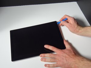

+[* black] Use plastic opening tool to pry around the base of the screen. Do this around the outside of the device. There are tabs on the upper right side and upper left side where it is easier to get a tool under the screen.
