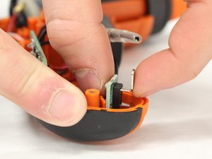

+[* black] Set battery aside in a safe place.
+[* red] Locate the battery contact board near the bottom/rear side of the screwdriver.
+[* black] Gently pull up on the battery contact board.
+[* orange] Locate the two solder joints on the side opposite to the contacts. Remove solder with soldering iron. Once the solder joints are removed, the battery contact board should be freed.
