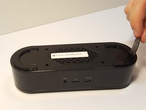

+[* icon_caution] Power off the device before you decide to take it apart
+[* black] Flip over the device
+[* black] Remove the silicon feet, by peeling them up
+[* icon_note] The silicon feet can be reapplied without extra adhesive, but only if you are careful not to let the stick side touch anything.
