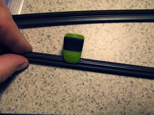

+[title] Inserting the new insert
+[* black] Insert the splines into the new insert. You may find use of a gentle clip to hold them in place will help.
+[* black] Insert the insert with splines into the blade groove, starting at the "soft edge" end. Gently work the insert into the blade and move/remove the clips as you proceed.
+[* black] I find that this is easiest to do with the blade held vertically, sliding the insert in upwards while hanging down to the ground. This keeps the splines hanging down with the insert, but the clips are really helpful to keep the splines from just falling or sliding out of the insert.
