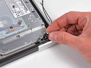

+[* red] Remove the 8.6 mm Phillips screw securing the antenna/camera cable retainer to the upper case.
+[* black] Remove the antenna/camera cable retainer from the upper case.
