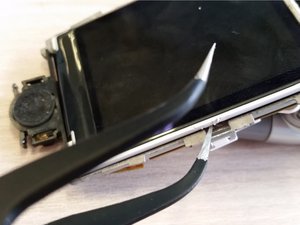

+[* black] At tabs in the middle of the long sides use tweezers to remove the screen from the plastic by slipping tweezers under the white tray holding the screen (try prying where one of the two rectangular holes are on the gray tray).
