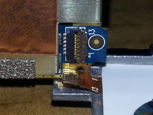

+[title] Removing The Main Board Part 2
+[* black] Do not try to remove the main board just yet, because there is still another cable attached underneath.
+[* black] Slowly lift the main board from the top of the phone and pivot it up. You should now see the connector. This connector is the same as the other two on top of the main board. Disconnect the connector the same way as you did before.
