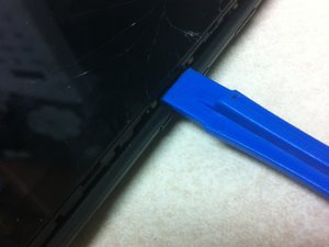

+[title] Open up the tablet
+[* black] Remove the MicroSD Memory card, Sim Card, and the metal Sim Card Holder.
+[* black] Put them off to the side for reassembly.
+[* black] Now you can slowly use a plastic opening tool to go around the edge of the tablet to slowly pry upward.
