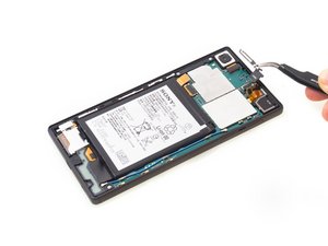

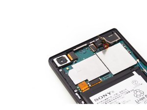

+[* black] Release audio jack flex connector and twist off the Phillips screws underneath.
+[* black] Remove the plastic bracket securing the front camera.
