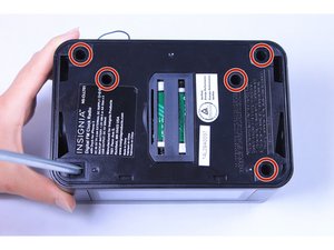

+[* black] Unscrew all six 10mm Phillips screws from the bottom of the clock with a long Phillips #2 screwdriver.
+[* icon_note] The screws may not come out of the bottom of the clock. As long as you have unscrewed them, the clock can still be opened.
