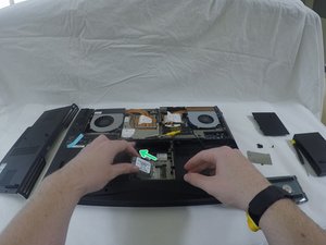

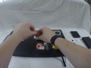

+[* red] ***Removing the mSATA Hard Drive*** is now much like in step 6, however, this time the hard drive faces the other way and the screw you must remove is on the ''left'' instead of right.
+[* green] Just like step 6, after unscrewing the hard drive, it should pop up and you can pull it straight out along that angle.
