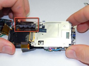

+[* icon_caution] Do not touch the black cylinder on the top edge. This is the capacitor for the flash and it may shock you.
