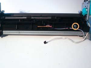

+[* red] Remove the large springs at each side of the fuser by pushing in on the plastic inserts.
+[* icon_caution] The springs will fly out violently if you do not hold them with pliers.
+[* orange] Remove one screw on the fuser.
