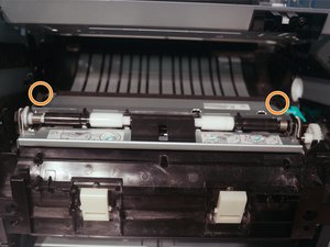

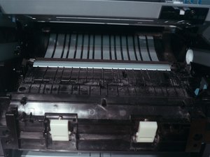

+[title] Registration Assembly
+[* red] Remove 2 screws to remove the paper feed bar.
+[* orange] Remove 2 (hidden) screws to remove the registration assembly.
