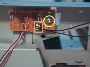

+[title] Duplexer PCB
+[* red] Disconnect the duplexer cable from the control board.
+[* orange] Disconnect the duplexer solenoid cable from the duplexer PCB.
+[* yellow] Remove one screw from the PCB and remove the PCB from the printer.
+[* black] This tiny board contains 2 NPN transistors marked [http://pdf.datasheetcatalog.com/datasheet/toshiba/967.pdf|C2120] and [http://pdf.datasheetcatalog.com/datasheet/toshiba/964.pdf|C1815], which are used to drive the duplexer solenoid.
