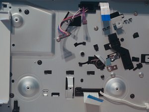

+[* black] Now on to the formatter.
+[* red] Remove 2 screws on the I/O port cover.
+[* orange] Remove 6 screws on the formatter cover.
+[* yellow] Disconnect 3 connectors to the laser assembly, the cartridge connector, and the control panel.
+[* green] Disconnect 2 flat flexible cables to the laser assembly and the control board.
+[* icon_note] While the service manual says not to use a PoziDriv screwdriver, I found that using a normal Phillips screwdriver on the screws in this printer would require excess force and damage the screws, but a PoziDriv screwdriver removed the screws without causing any damage.
