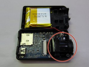

+[* red] Locate the camera module.
+[* black] Grab the sides of the camera module and gently pull to free it from the case.
+ [* icon_caution] Be gentle when handling the camera module to avoid damaging the fragile ribbon cable attached to it.
+[* black] Use your finger to pull up the black tab on the rear of the ribbon cable connector.
+[* black] Slide the ribbon cable out of the connector to remove the camera module.
+ [* icon_reminder] When plugging the ribbon cable back into the connector the copper pads face upwards.
