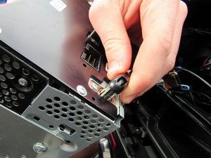

+[* black] Unplug both the white and black wiring harnesses by pressing the small tab above the socket connector. Also remove the antennae cord by sliding it from its housing.
