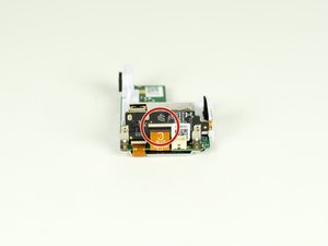

+[* black] Remove the larger ribbon cable from the daughter board by lifting the black latch and pulling the ribbon cable gently from the socket.
+[* black] Disconnect the smaller ribbon cable by simply pulling it from the socket.
