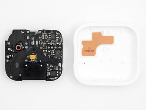

+[* black] A break down of the top side of the PCB:
+ [* red] Rubycon 4.7µF 400V electrolytic capacitor [http://www.rubycon.co.jp/en/catalog/e_pdfs/aluminum/e_AX.pdf|400AX4.7M8X9]
+ [* orange] Fairchild bridge rectifier [https://www.fairchildsemi.com/datasheets/MB/MB10S.pdf|MB10S]
+ [* yellow] Everlight optoisolator [http://www.everlight.com/file/ProductFile/EL3H7-G.pdf|EL3H7-G]
+ [* green] Transformer markings 157-00003 / HIG J 1503
+[* icon_note] There's copper shielding to meet EMC requirements on the rear of the housing.
