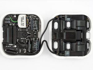

+ | [* black] As is more and more common on mains chargers, most of the design is fastened together during the moulding process. There is only a single screw in the entire product. |
+ | [* black] You could possibly pry this open, but you would likely make a big mess. Instead this has been cut in two using a fine bladed coping saw. |
+ | [* black] This was cut 1mm behind the USB port entrance. |
+ | [* black] Inside we can see the design has been split into two halves. |
+ | [* black] All of the electronics are on a single PCB on the left. |
+ | [* black] All of the mechanism and high voltage contacts are on the right hidden under plastic hood. |
