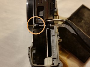

+[* black] Flip the screen over ,but be sure to keep the film connected.
+[* black] This will give you access to the metal plate that will need to be removed using the same size screws and screw driver.
+[* black] This will give you access to the push pin holding the cover in place
+[* black] Use a small needle or pin to slide the pin right out. Be sure to keep the pin and spring in a safe spot to prevent loss. ( The image shows me using a pair of thin needle nose pliers)
