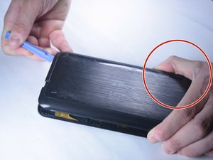

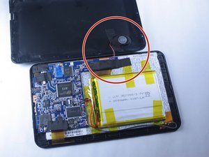

+[* black] ***IMPORTANT NOTE***: When removing the back panel of the tablet, take caution around the speaker. This is located in the lower right corner when looking at the back of the tablet. There are two wires inside connecting the tablet back panel to the device itself and this connection may be severed the back is pulled off without care.
+[* black] This connection is shown circled in the pictures.
