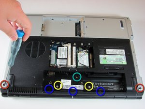

+[* black] Remove the two Phillips PM2.5×11.0 screws at the corners on either side of the batter compartment. (shown by the red circles)
+[* black] Remove the three Phillips PM2.5×6.0 screws. (shown by the blue circles)
+[* black] Remove the two silver Phillips PM2.5×5.0 screws. (shown by the yellow circles)
+[* black] Remove the Phillips PM2.0×6.0 screw in the middle of the battery compartment. (shown by the teal circle)
