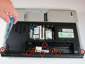

+[* black] Remove the two Phillips PM2.5×11.0 screws at the corners on either side of the batter compartment, the three Phillips PM2.5×6.0 screws and the two silver Phillips PM2.5×5.0 screws, and the Phillips PM2.0×6.0 screw in the middle of the battery compartment.
