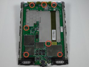

+[* black] With the motherboard facing you, use the pointy end of your Spudger to gently separate the speaker's connectors.
+[* icon_reminder] During reassembly, make sure the speaker's connectors are not pushed behind the motherboard.
+[* red] Use your #00 Phillips Screwdriver to remove the seven 2 mm screws.
