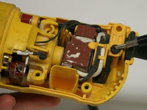

+[* black] To replace the electrical switch. Remove the back panel as shown in the prerequisite steps after the mechanical button has been removed.

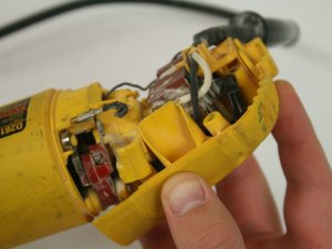

+[* black] once the back panel has been removed, unscrew the power cord clamp
+[* black] Once the clamp has been removed. remove the second side of the back panel.
+[* black] The red box is the electrical switch
