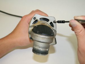

+[* black] First start by unscrewing the four screws on the front panel

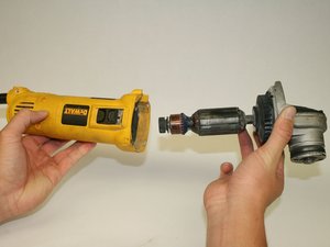

+[* black] Then pull the front panel out off of the plastic body. The motor shaft is attached to the front panel so it will pull out of the plastic body sleeve with the front panel.
